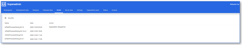

The Builds tab
See the illustration below.
Below is a description of the elements of the Builds tab.
| Element | Description |
| Builds menu | Contains options for managing builds. |
| Name | The name of the build package. |
| Date | The date on which the build was created. |
| Active | Indicates which build is activated as Superadmin build and/or Dispatcher build. |
