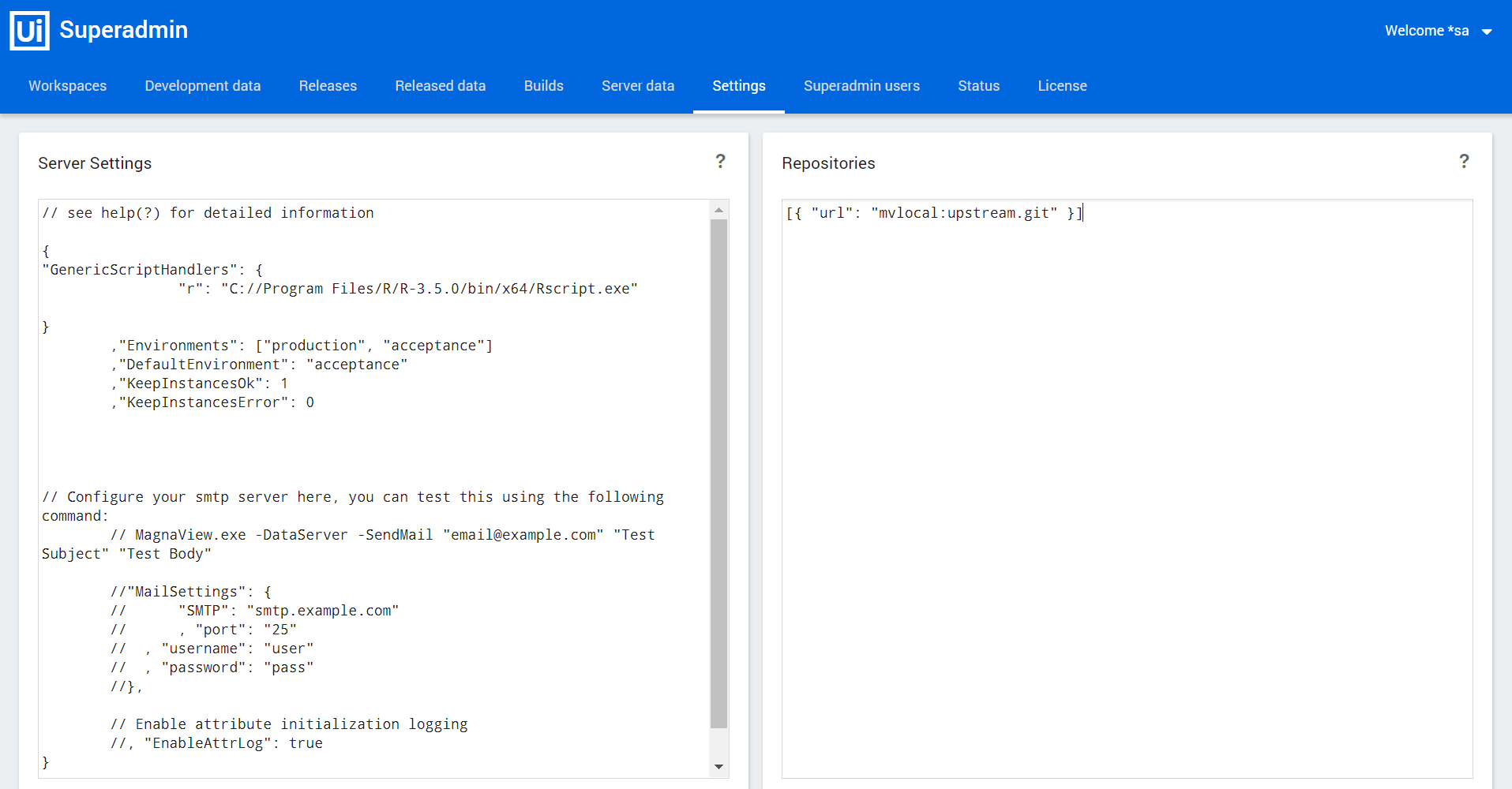

By default, the server is configured as strict as possible. In the Server Settings field of the Settings tab, you can make changes to the server configuration. These settings are noted in JSON.
See the illustration below.
docs image
