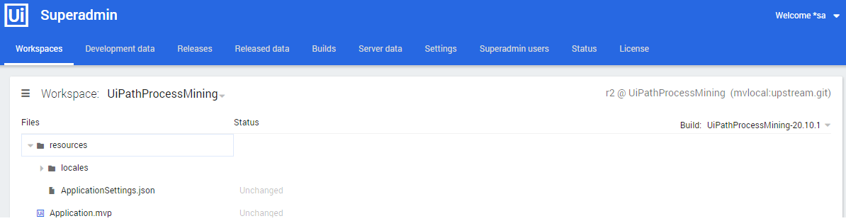

From the Workspaces tab, you can create and manage your personal workspaces. Moreover, you can create releases, generate translation files and change the default application settings. See illustration below.
docs image
Below is a description of the elements of the Workspaces tab.
ElementDescription
Workspace menuThe Workspace menu contains items that you can select to create and manage your workspaces. See the illustration below.
Workspace drop-down listEnables you to select the active workspace.
r91 @ UiPathProcessMining (mvlocal:upstream.git)Current revision (r391) @ branch (UiPathProcessMining) in repository (mvlocal:upstream.git).
Build: UiPathProcessMining 20.10.1The current UiPath Process Mining version that is used.
FilesA list of all the folders and files in the current workspace.
StatusThe status of the files in the current workspace. If there a local modification that are not committed yet, the status is Changed and the modification date is displayed. In case there are no modifications, the status is Unchanged.

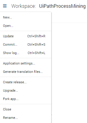

Workspace menu
You can display the Workspace menu by clicking on the menu icon.
Below is an illustration of the Workspace menu.
docs image
The table below describes the items of the Workspace menu.
Menu item
Description
New...
Enables you to create a new app which can be based on an existing app. A new branch and workspace are created automatically.
Open...
Enables you to open an existing app whilst creating a new workspace on the current branch.
Update
Enables you to update the current workspace to the latest revision and to see the changes that other team members have made.
Commit...
Enables you to save your local modifications from the workspace and to create a new revision.
Show log...
Opens the Log Messages dialog, showing the current state of your workspace and the history.
Application settings...
Opens the ApplicationSettings.json file where you can define app specific settings, for example for app translation.
In general, application settings are used to customize the look and feel of your apps.
See The Workspaces Tab
Generate translation files...
Generates a .json file for the translator for each supported language that you have defined in the ApplicationSettings.json file. The translation files will contain all keys that require translation.
See Translate Apps .
Create release...
Enables you to create a release that can be used to make your app available to end users.
Note: if there are local modifications in the workspace you must commit these to the branch first.
Upgrade
Enables you to upgrade an app to a newly released version of the app on which your app is based. All changes you made are merged to the new version.
Fork app...
Enables you to fork an app in case you want to duplicate an app . For example, to start a new app by using an already existing app as the basis.
Close*
Enables you to delete the current workspace.
Note: this does not delete the branch.
Rename...
Enables you to change the name of the current workspace.
  • In UiPath Process Mining 2021.1 the Delete option was renamed to Close.

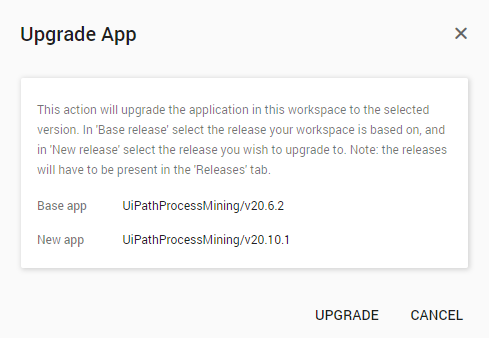

Upgrading an App
note
Before you can upgrade your app, the released version of the app of the same release your modified version is based on and the newly released version of the app must be uploaded to the Releases tab.
Follow these steps to upgrade an app to a newer version.
Step
Action
1
Go to the Workspaces tab and select the workspace that contains the .mvp file of your app.
2
If your workspace contains any local modifications, click on the Workspace menu and select Commit... .
3
Click on the Workspace menu and select Upgrade... .
4
If you have selected a Base app when you created the app, or when you have upgraded the app before, the Base app is automatically selected. If not, then select the released version on which your modified version is based from the Base app drop-down list in the Upgrade App dialog.
Note: Make sure that you select the correct Base app for the upgrade to prevent merge problems.
5
Select the released version to which you want to upgrade from the New app drop-down list.
6
Click on UPGRADE . See illustration below.
7
Open your customized app and check whether it was successfully upgraded.
8
Click on the Workspace menu and select Commit... .
docs image
note
After the upgrade the Base app is set to the version selected for New app.
See also: Updating a Customized Version of an App or Discovery Accelerator.

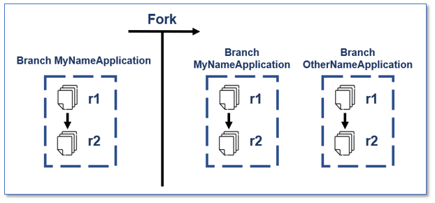

Fork an App
It is possible to fork a app in case you want to duplicate an app. For example, to start a new app by using an already existing app as the basis. Forking an app creates a new branch. This branch contains the history of revisions up until the one your app was based on.
docs image
Follow these steps to fork an app.
Step
Action
1
Go to the Superadmin Workspaces tab.
2
Click on the Workspace menu icon and select Fork app... .
3
Click on App name next to New app name and enter a name for the new forked app.
Note:
• the name must start with an alphanumeric character and can contain hyphens, underscores, and full stops.
• the name cannot be changed.
4
Select the option Switch to the new app to open the new workspace on the new branch that will be created for the forked app.
5
Click on FORK APP .
This creates a app in a new workspace on a new branch, including any local modifications you had.
