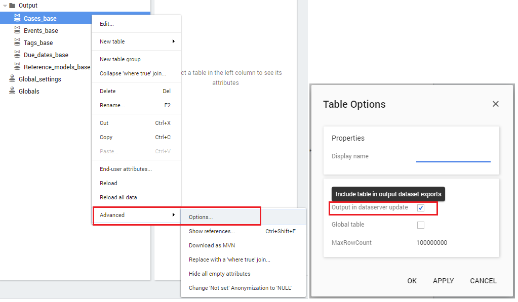

Output in dataserver update option
To export the output table to the output dataset the Output to dataserver update option must be selected in the Table Options dialog.
| Step | Action |
| 1 | Go to the Data tab and right-click on the table you want to include in the output dataset. |
| 2 | Select Advanced - Options... from the context menu. |
| 3 | In the Table Options dialog make sure the option Output in dataserver update is selected. |
| 4 | Click on OK. |
See illustration below.
By default, this option is enabled for the output tables in the Basic Connector.

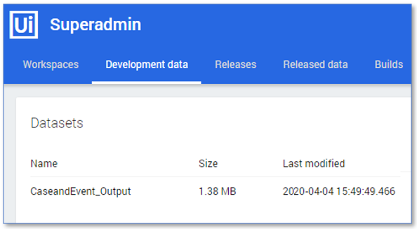

Exporting the output dataset
If you have made changes to the data in the Connector you need to create the output data set.
Follow these steps to export the output dataset from the connector.
| Step | Action |
| 1 | Click on the logo icon and select Advanced - Export output dataset.... |
| 2 | Enter a name for the dataset in the Export Output Dataset dialog, for example CaseandEvent_Output, and click on OK. |
| 3 | Close the Connector and open the Superadmin Development Data tab. |
The output dataset is displayed in the list of development data files. It can now be used in AppOne. See illustration below.
