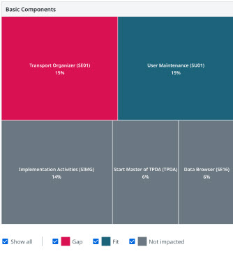

Change Impact Analysis, similar to the Heatmap offers a two-level view:
  1. Application components—containers inside the heatmap that contain all the transactions used inside a specific application component.
  2. Transactions—boxes inside the application containers that contain data about a certain transaction or program, such as: name, SAP code, and the percentage of test relevance in the heatmap. Yon can zoom in on a selected area of interest and focus only on a specific SAP component or module.
    1. Gap - The transactions impacted by the selected transports that are not covered by test cases.
    2. Fit - The transactions impacted by the selected transports that are covered by test cases.
    3. Not impacted - The transactions in the transport weren't impacted by the change.

View the test coverage of impacted transactions
In the Change Impact Analysis view you can see the transactions impacted by changes within a transport, and their relevance in your SAP system, based on the ratios you configured for the Heatmap.
To see the impact of changes within a transport on your transactions:
  1. Under the heatmap, select Gap to see the transactions that are impacted and aren't assigned to test cases.
  2. Under the heatmap, select Fit to see the transactions that are impacted and are assigned to test cases.
  3. Under the heatmap, select Not impacted to see the transactions that aren't impacted by the changes.
  4. Select Show all (selected by default) to see all the above transactions.
