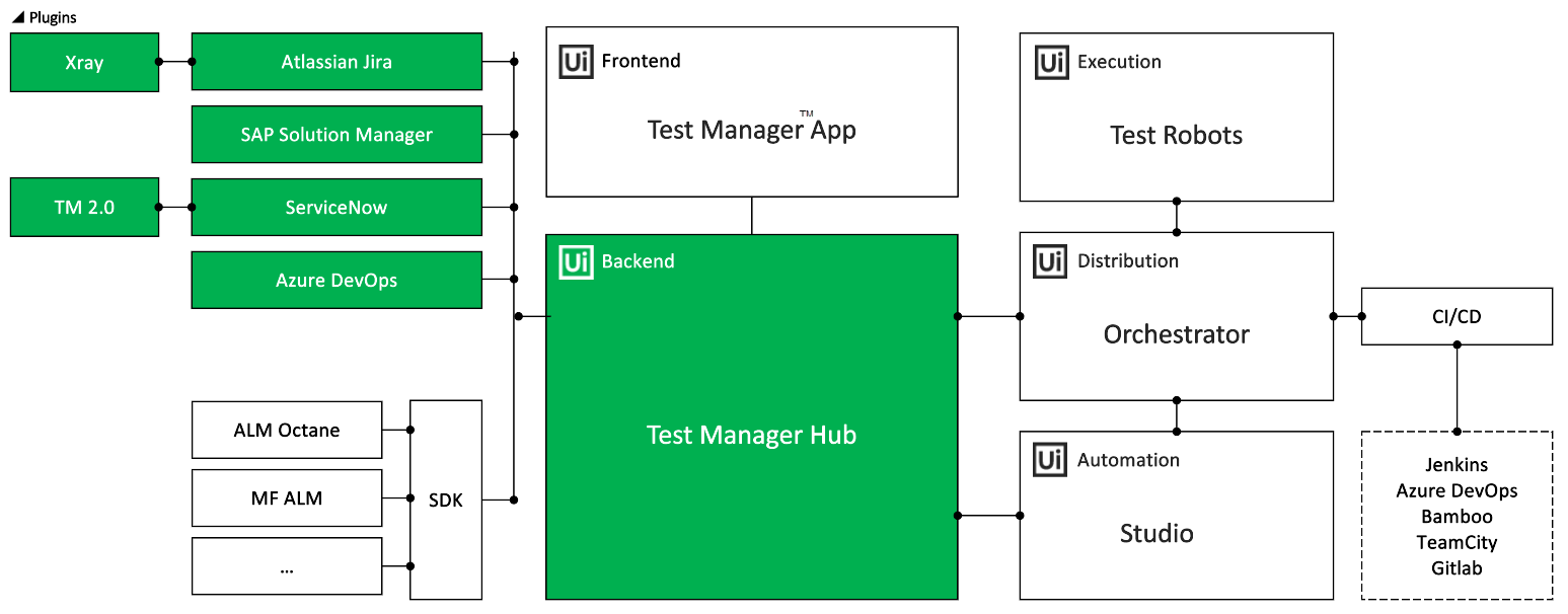

The following architecture diagram describes the integration capabilities with UiPath® components and 3rd party tools. For more information, see Application Lifecycle Management Integration Patterns.
