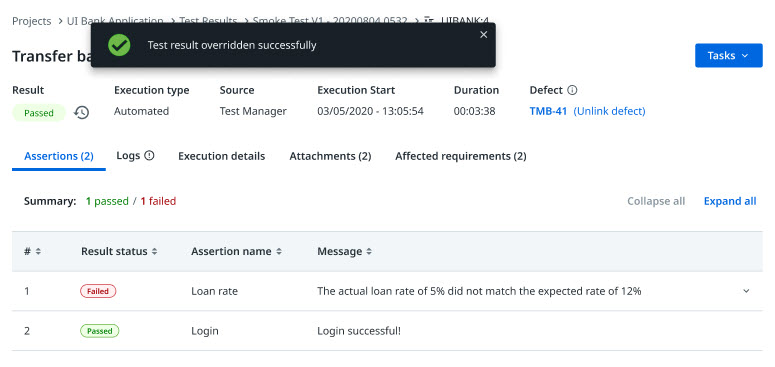

Overriding test results
Overriding the results of a test case can help in scenarios where the current test result does not accurately reflect the actual behavior of the application and re-execution is not an effective solution. You can override the test results of a test case and then you can clear the operation, if needed.
  1. Navigate to Test Results and open a test result.
  2. From the Results tab open a test case log.
  3. In the Assertions tab, select Tasks > Override result.
  4. In the Override test result window configure the following fields:
    1. Change result to - select whether you want to override the result with the opposite status (Passed/Failed) or set the result to None.
    2. Comment - Type the reason why you override the result.
  5. Select Confirm. The test results that you overrode have the following icon next to the test result status: . Select the icon and you can view the override details.
    docs image
  6. Optionally, if you want to clear the override operation, select the docs image next to the result status of a test case log.
    1. In the Override details window, select Clear override.
      docs image
  7. Optionally, if you want to edit the override operation, select the docs image next to the result status of a test case log.
    1. Perform changes, and click Confirm.
